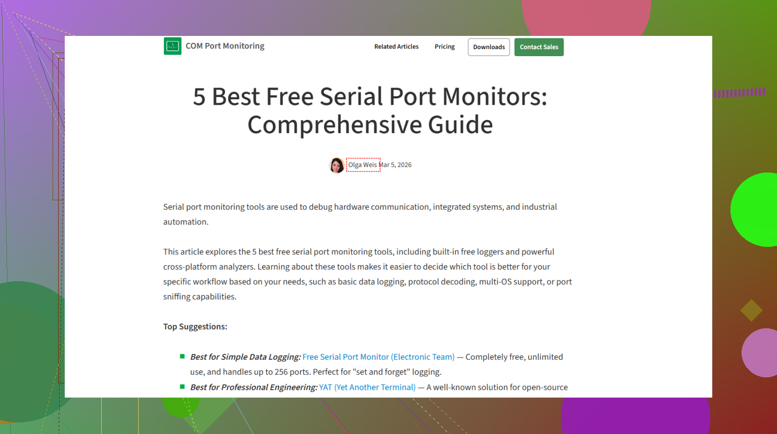

2. You want actually good free serial COM tools, without junk
This roundup is decent for comparing options and finding what fits your setup:
top-rated free tools for reliable PC to microcontroller serial debugging
