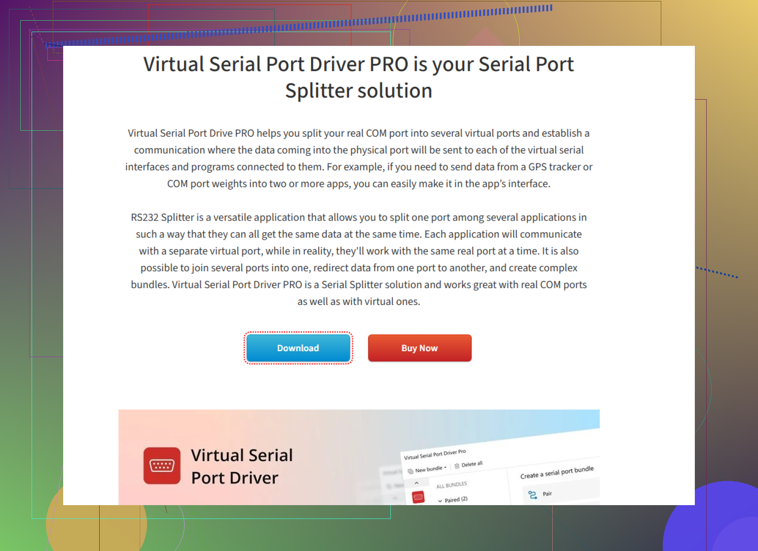

For two applications on the same PC, I’d have the splitter own the physical COM port exclusively and expose a separate virtual COM port to each application. Both virtual ports should receive cloned input. That is cleaner than pointing both programs at one shared virtual port, especially when an older application expects exclusive access. The basic distinction is covered here with serial splitter explained, and it is the arrangement I’d look for when configuring Virtual Serial Port Driver or similar software.

A linked pair is the wrong setup when both programs need the same device data because it connects endpoints rather than cloning the stream. Virtual Serial Port Driver makes the port mapping especially easy to inspect, while the COM splitter app is the dedicated route for assigning each program its own feed.

For the actual local two-app case, the separate-virtual-port approach is the sane default, and yeah, Virtual Serial Port Driver handles that arrangement without much fuss. Just don’t skip the boring part: pin the USB adapter to a fixed COM number in Device Manager before you build anything on top. I’ve watched people configure everything perfectly and then lose it all because Windows handed the adapter a new port after a firmware update. Lock the number first, then split.
